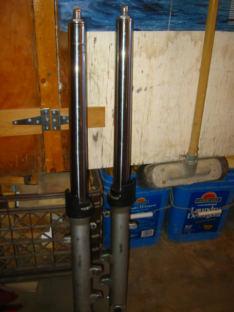

Ahora me esta rondando hacer esta modificacion... para la horquilla delantera...
[quote name='HispanicSlammer' date='Dec 29 2004, 05:08 PM' post='105421']
This modification is actually pretty standard for upgrading VFR forks. To take the Cartridge/Fork Caps from a CBR and install them into a VFR. For a 5th Generation VFR such as my 1998 VFR the cartridge from an f3 will work, and for a VTEC the Cartridge from an F4 will work. I found a set of 96 F3 forks on Ebay that were sort of in bad shape. Tubes were bent a bit but not enough to bend the cartridges. The fork lowers also had some epoxy over a hole in the fork. I did not ask why I can only assume a collision with something.
I did not need those parts anyways just what was inside.
Here is how they arrived, unfortunately they came in a box that was the wrong size and was taped with Duct tape, one of the forks actually punctured the box and so there was some damage to the fork cap from impact with something hard.
I only paid $75 bucks for the darn things so I did not complain, but not good feedback. But delivered as stated in the auction - I know I know for those of you who know about my problems with Ebay and VFRd I have since decided to move on and not try to fight Goliath anymore, not worth it. Call me a Hypocrite if you will for using it.
The forks were missing the snap ring and the bushings and oil seal were loosely hanging out, and the epoxied fork bottom was pretty ugly. I removed the fork caps and slid the long adjustment tube out of the damping rods, removed the springs and spacers.

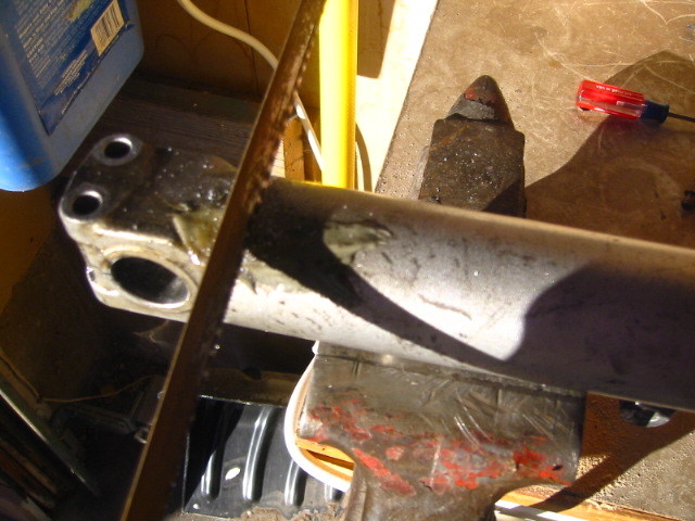

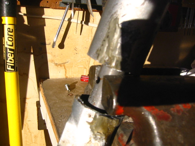

This is where I ran into problems, apparently the guy who sold these to me had already tried to remove the cartridges cause all the oil was gone - fine with me less mess!
However when I put my Allen wrench on the bottom of the fork to remove the bottom bolt it would just spin - I tried applying tension to the damping rod to get a bite on the screw but the bolt just continued to spin without unscrewing. I HAD TO GET MID-EVIL ON IT!!

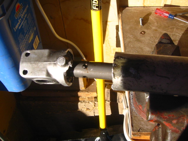

YUP thats a hacksaw! Look at that awful epoxy job. I just cut off the lower part of the fork to gain access to the cartridge.
You see what was happening is the bolt had frozen into the compression valve body and was spinning the valve around inside the cartridge - nothing I could do but cut the thing open to get to the cartridge.
Here you can see the cartridge bottom and the bottom of the fork cut off I was careful not to damage the actual cartridge itself.
I pulled off the top of the fork body as much as I could

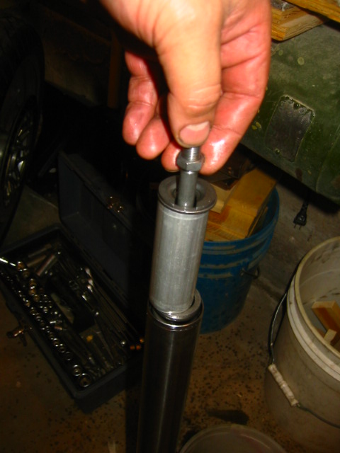

The fork tube will not come off until the cartridge is unscrewed there is a flange that prevents it from coming off. What I did now was maneuver the cartridge bottom onto my vise so I could clamp the compression valve and prevent it from spinning. It worked, I was going to toss the F3 compression valve anyway.

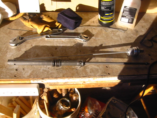

Two months ago I replaced the compression valves on my cartridge with Race Tech Gold Valves, they are the same size as the F3 valves so I just transplanted my Gold Valves into the F3 Cartridge.

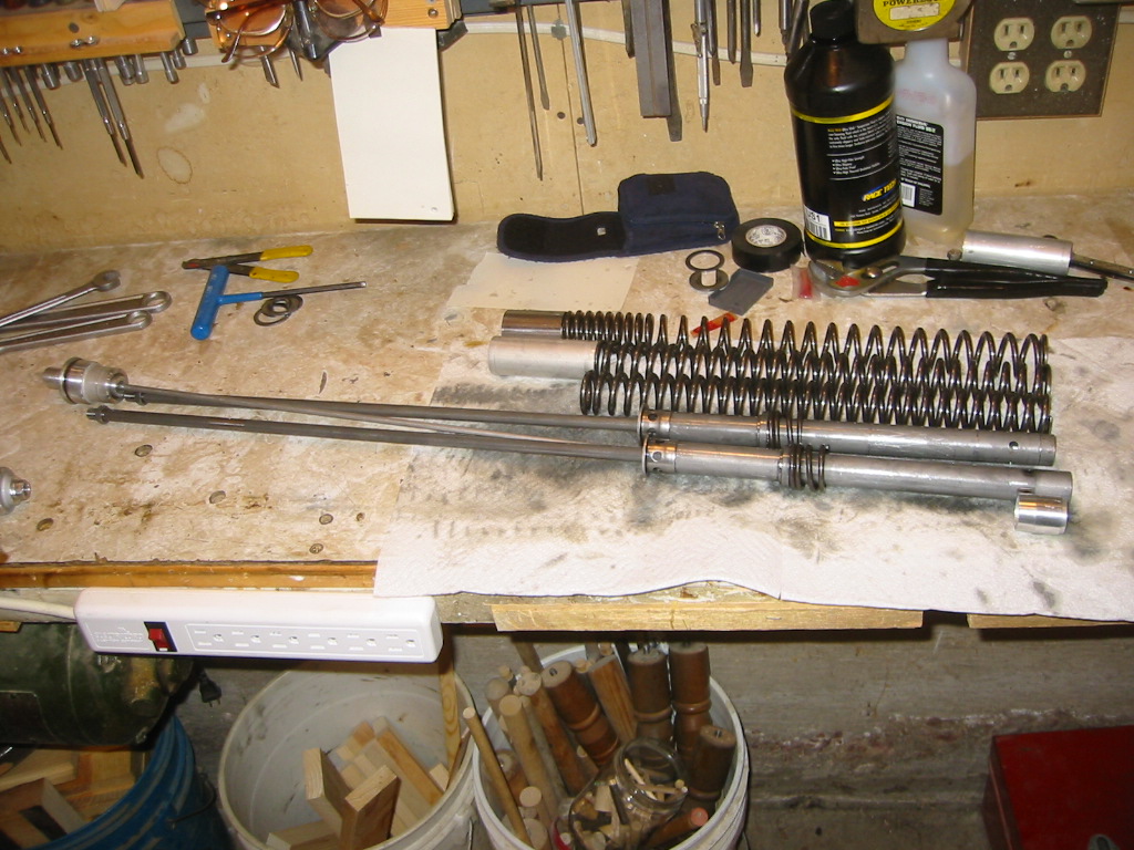

Here you can see the parts I needed
The F3 cartridge, the fork cap and with the rebound adjustment rod are the parts I needed. looks almost the same as the VFR cartridge but with that adjustment rod that slides down the damping rod tube.

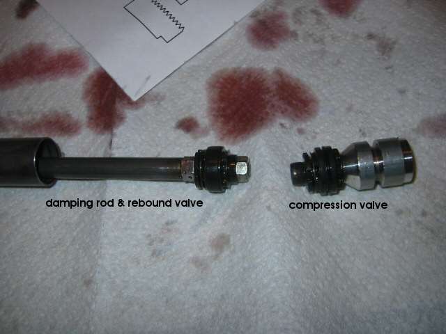

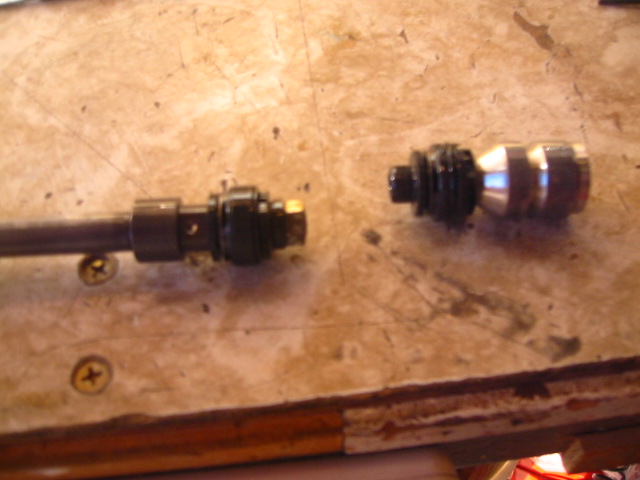

After removing the locking clip on the bottom of the F3 cartridge I removed the Rebound and Compression Valves.

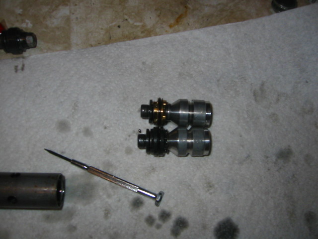

You can see the rebound valve is a different design from the VFR valve but the compression valve is the same - no adjustment.
This is a picture of the original VFR valves notice the difference.
The F3 rebound valve has a hole that can be opened like a faucet, there is a long rod that can be moved up and down to open the hole to control the flow of oil.

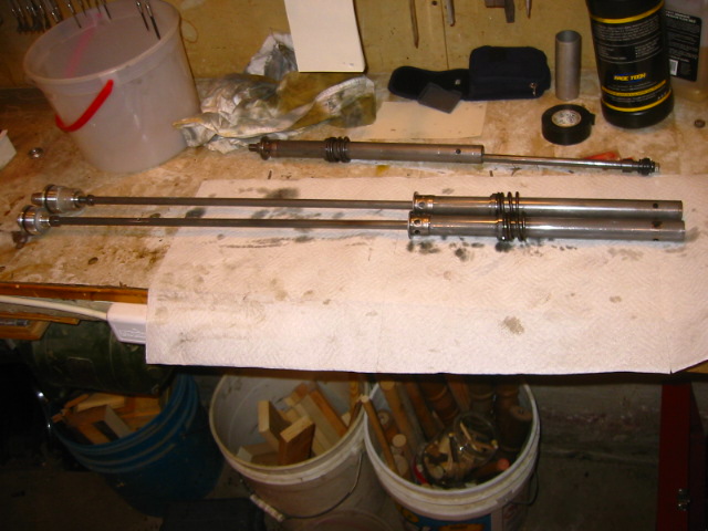

Here you can see a side by side comparison of the two cartridges
The F3 is shorter but has a longer fork cap, the VFR also had a fork oil lock piece that serves as a spacer cause the forks extend longer on a VFR due to the difference in rake between the two bikes. Longer rake requires longer forks.
Here I am transplanting my Gold-valves compression into the F3 fork.
I also transplanted my Gold Rebound valves into the F3 forks. I decided to make an adjustment on the compression valve by removing one .15 x 17mm shim for a bit softer ride, the ride was still a bit harsh. Race Tech shim stacks are designed for racing and so can be a bit harsh on street applications, its just a matter of removing a shim to your liking. They actually provide a series of recipes for different shim stacks to give you a harder or softer ride - mostly its just a matter of adding a shim or taking one off from the recommended recipe.
If your not quite sure what I am talking about I wrote a more detailed description of the VFR Valves in this Thread its a more detailed reference piece with diagrams and such, refer to it if you need more info.
Intalling Race Tech Gold Valves

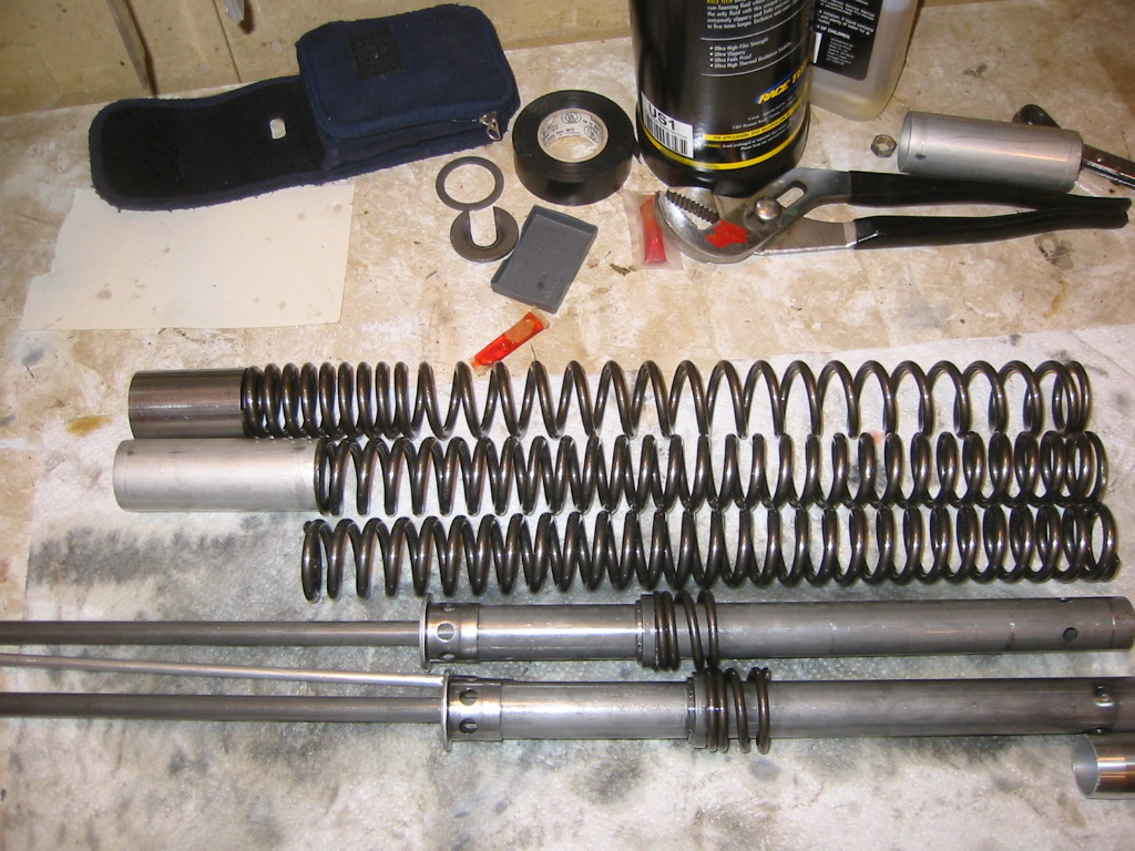

All the pieces side by side
The Springs side by side
I thought I might need to adjust the size of the spacers on my springs - I use Race Tech springs designed for my weight. They are stiffer than the Honda Springs and are single rate. So I put the spacers and springs side by side and they turned out to be the same length together. so I did not cut the spacers to compensate. I may still need to cut some of the spacer to get the bike to sag right but from looking at them side by side I determined that they do not need to be cut as of yet. It all depends on if the bike sags properly when I get them back on the bike. I decided to put the oil lock piece from the VFR cartridge on the bottom of the F3 cartridge. The F3 just bolted right into the compression valve.
The VFR had that lock piece in there between the compression valve and the bottom of the fork.

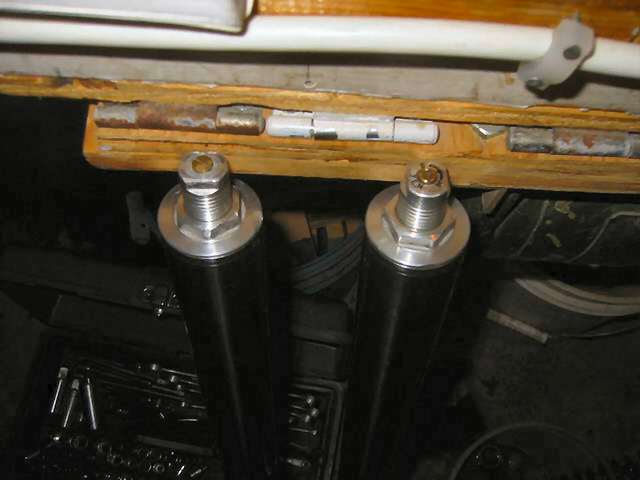

All put together.
It looks like the bike sits a bit high with the preload backed all the way out, I still have to measure the sag so I may still have to cut the spacers I will report on that later after I do my sag measurement.
Springs, spacers, washers, lock-tip all installed.

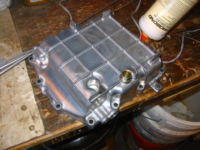

I also solved my oil leak by just buying a whole new oil pan. I stripped out the threads on the oil plug on the old one and tried to repair it with some metallic epoxy. Did not work! I called around to machine shops to bore it out and tap it for a larger plug. Ended up just as cheap to get a new oil pan!
Brand New Oilpan

No entiendo nada de lo que hace, porque corta la botella de la horquilla si hay un tornillo debajo para soltar el hidráulico. Como lo arma luego todo. No se no le veo ni pies ni cabeza.
Vssssssssss
el tornillo estaba reventado champa... por eso corta la botella.
