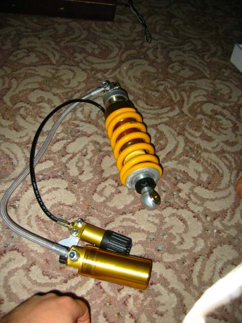

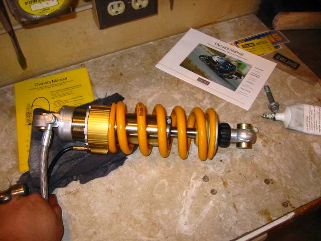

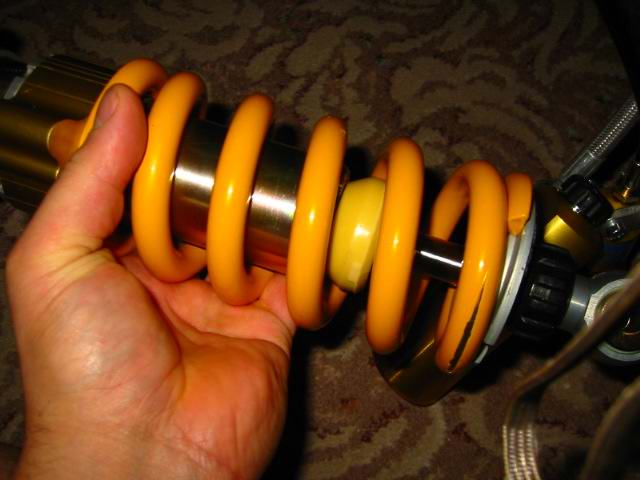

I took advantage of the Ohlins sale at Cyclemall.net and ordered one for 1998 VFR, my shock has 28k miles on it and 5k of that loaded down, the shock was getting bouncy and wore out.
As you can see this version has a few features.
  • A Remote Hydrolic Preload adjustment
  • A remote gas and oil cannister w/finger stylecompression adjuster
  • Finger style Rebound adjuster

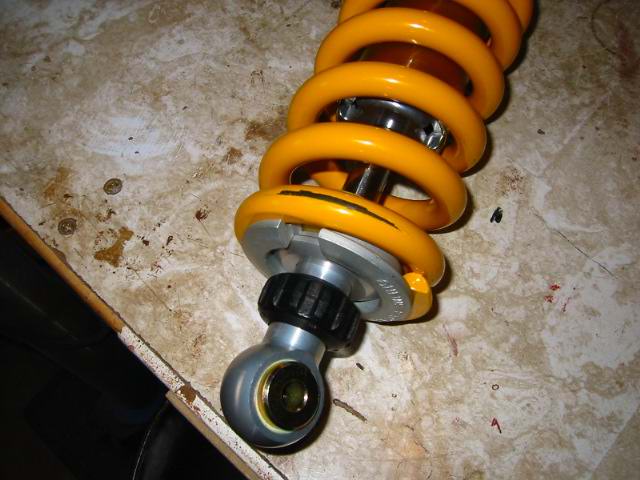

The shock comes with a rubber stop in case you bottom out
I was a bit disappointed to find the spring had paint scraped off, However this spring is set for my weight and riding style, I just touched it up. The rebound damping setting is that knob on the bottom

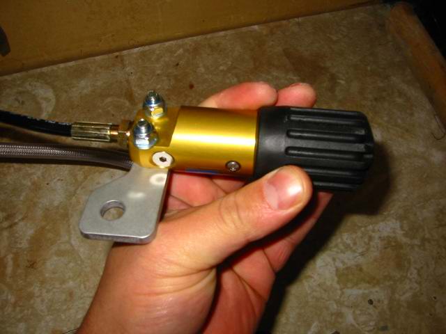

This is the hydraulic preload adjuster, this spring is stiffer and is also shorter so they screw it down a bit to get it set up correctly.
This is the remote preload ajuster

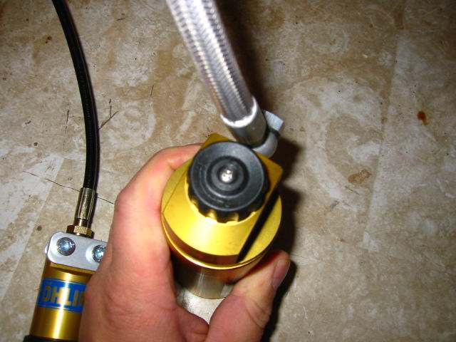

This is the gas and oil reservoir the compression damping adjustment screw is here

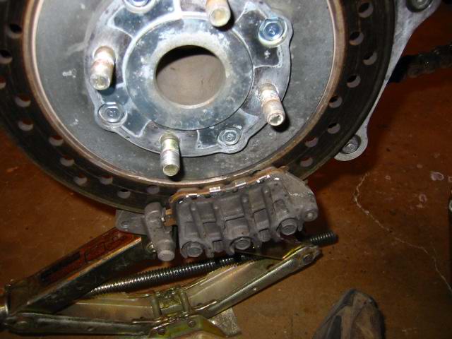

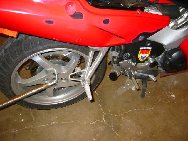

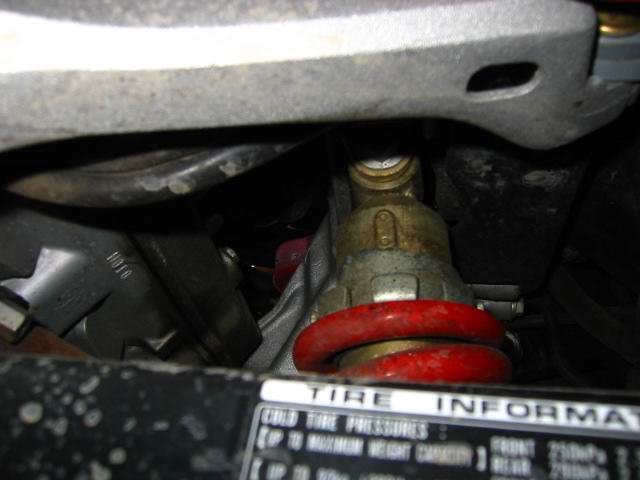

Begin By Removing the Exhaust and Rear Wheel

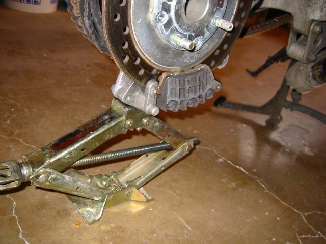

I used a scissor jack to support the rear when removing the old shock

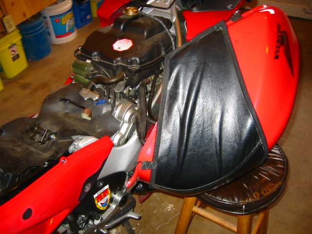

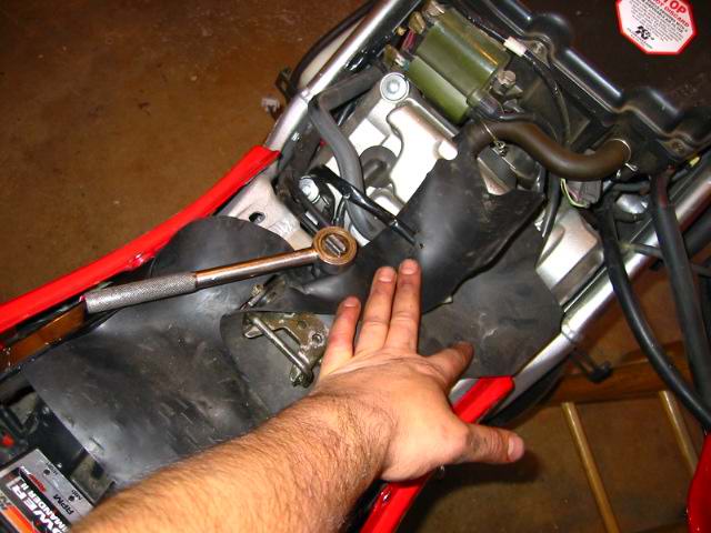

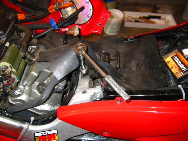

You must remove the gas tank to gain access to the upper shock bolt.
As you can see here the upper U bracket is very cramped, it is easier just to remove it from under the seat
Here is the upper bolt under all those rubber pieces

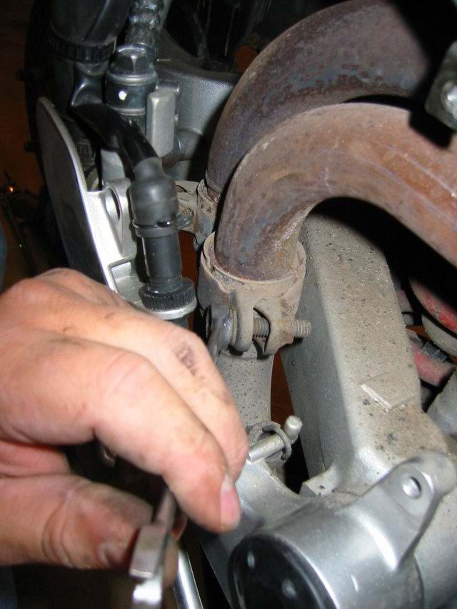

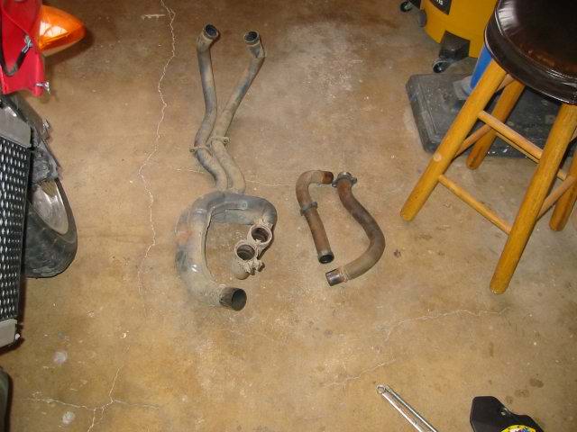

The headers are in the way
The headers must be moved and dropped down out of the way

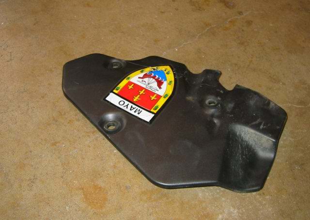

Remove the heat shield - 3 hex screws
You can loosen the assembly enough to make room but I decided to remove them.

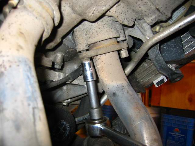

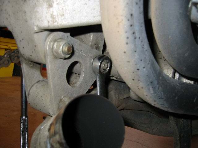

The Rear headers have a coupling that must be loosened and taken off behind the heat shield 12mm bolts.
Remove the front header bolts 2 on each side of the pipe, 10mm and they were not very tight.
Boy they were dirty and rusty!

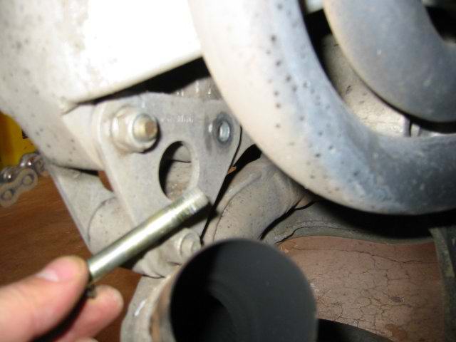

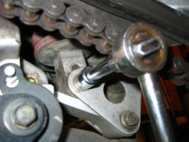

Now you can remove the rear linkage and the old shock 12mm bolt 14mm nut

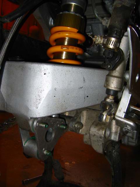

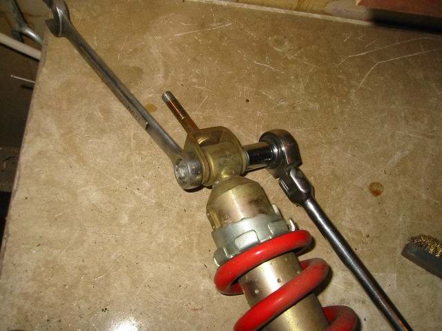

I removed the old shock by letting it drop down, holding on to it, you have to remove the U bracket cause you need that again

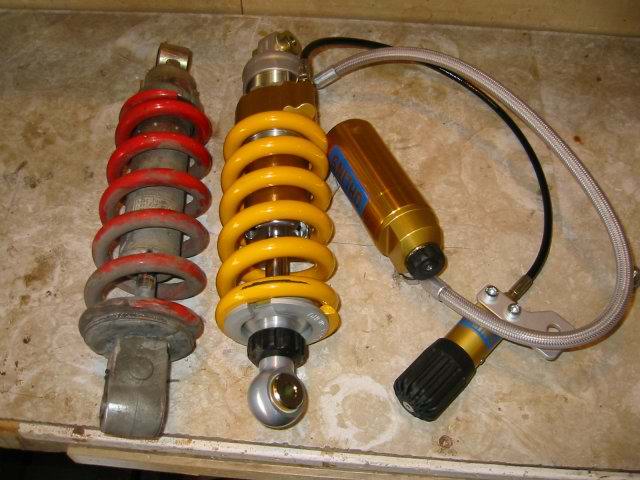

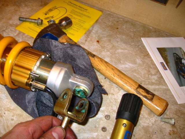

Side by side comparison, notice anything funny, THE BONE HEAD HAS THE BEARINGS BACK-WARDS! The short one goes up and the long one goes down! I was peeved to say the least.
Well I spent 20 minutes hammering them out and pressing them into the correct position with a vise, now they are on correctly, these bearings are just solid no needle bearings like the OEM shock has.
There was no way I could just run it upside down, cause the remote lines would bind and also the U bracket will only fit on the top side of the shock. Igreased everything up nicely.

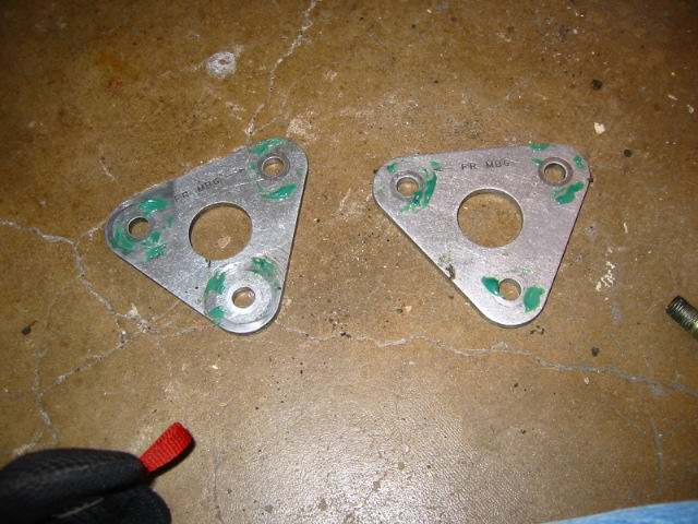

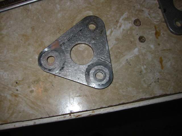

You can see here the linkage triangle has some grooves in it, I ordered replacements, when I took it off there was some sand in there that must have been picked up off the road that made those grooves. Just like what happened to Lewis.

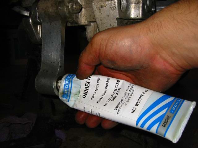

I pulled out the inner bearing on all the linkage pieces cleaned them up and greased everything, the same thing on the swing-arm mount too.
I threaded the remote res and preload thru the hole in the swing-arm first them lifted the new shock in place, bolted it up-top loosley.
A little grease on the triangles, they have a line on them to show you how they go.
I lined up the holes and shot the bolt thru, the scissor jack came in handy here to line up the shock. Tighten the 3 bolts to 33 ft/lbs

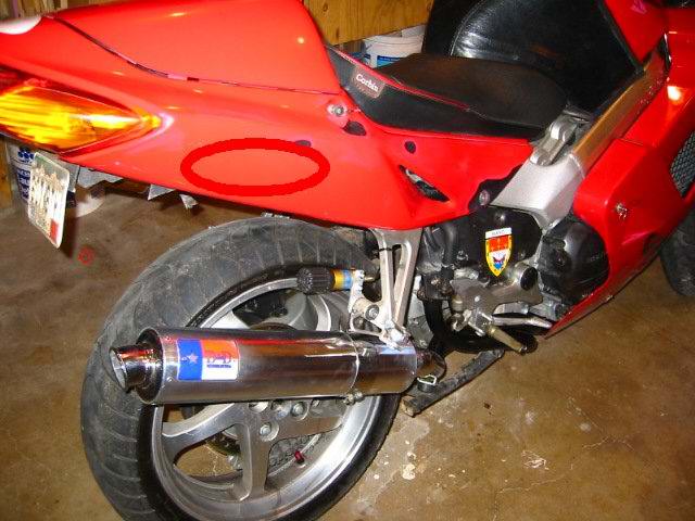

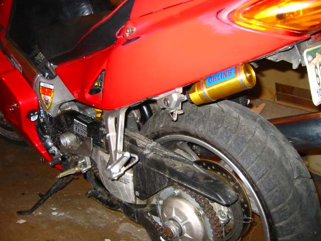

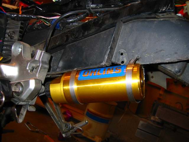

This is where I mounted the remote reservoir on the left side. cut notches in the plastic to take the clamps
I wanted to show it off, they tell you to mount it under the rear fairing, at least I can adjust it the way I did it. You can also see they mount the preload adjuster to the exhaust hanger.

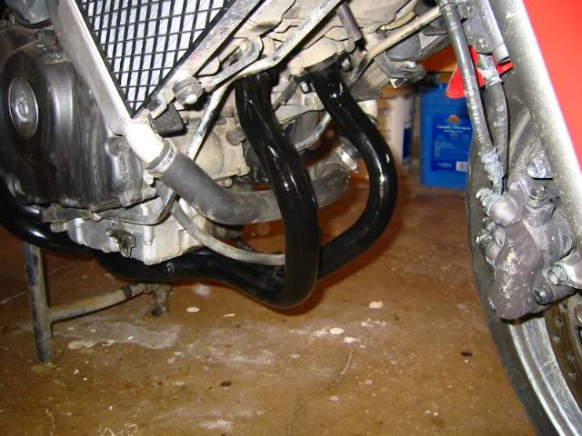

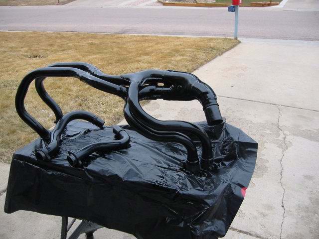

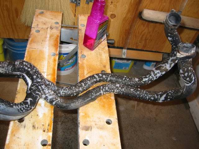

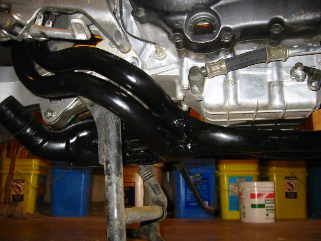

Painting the headers
The headers were all rusty on the bottom so I decided to paint them with some heat resistant black paint after I washed them
Thanks to Smeg for the Idea!

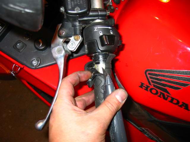

I also put on some new grips I had in the closet, finally installed them, Here is a tip if you don't want he old ones just cut them off
